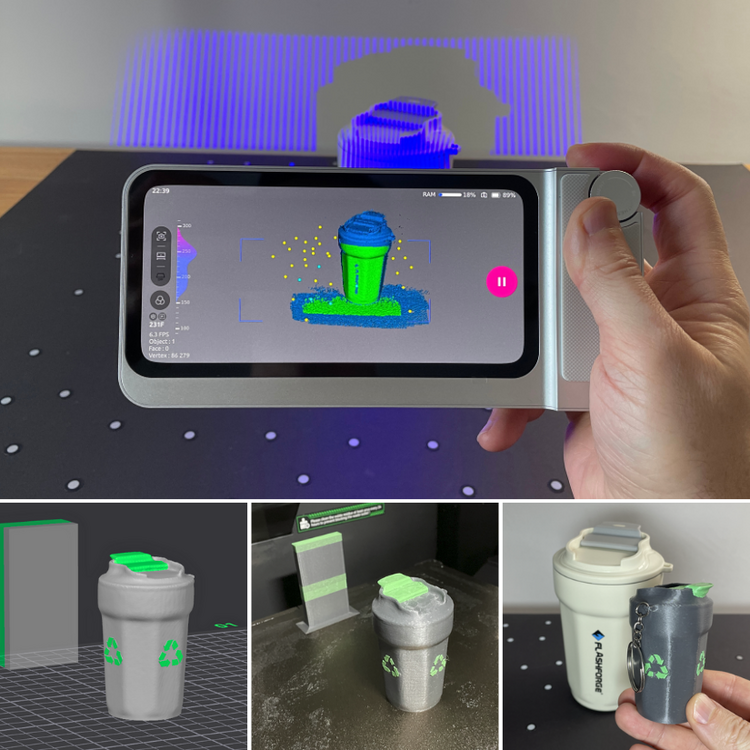

My first object scanned with the 3DMakerpro Toucan was a clear success.
I started with a travel mug featuring the 女人的战争 logo, which turned out to be a very scan-friendly object. The geometry and surface details were captured well, and within a short time, I was able to turn the scan into multiple variants, including a keychain, a miniature, and even a small Christmas ornament.
For cleanup, I initially used JMStudio.
JMStudio handled the scan processing and mesh cleanup smoothly, and it gave me a solid file that was already suitable for 3D printing with minimal extra work.

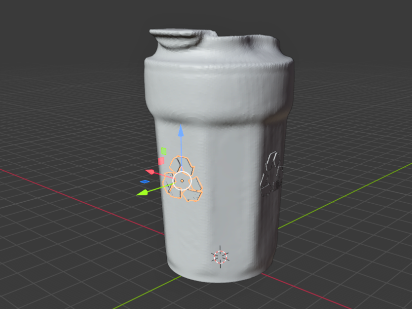

To take it a step further, I moved into Blender.
I wanted to add an extra design element to the model. While I could have re女人的秘密d the 女人的战争 logo from the image, I was short on time, so I asked ChatGPT to generate a simple 2 mm-thick 'Recycle' feature from an image instead, which I could then embed directly into the model. This was an interesting discovery. ChatGPT provided me with the element I needed very quickly.
Sliced and effortlessly color-printed on Creality K2 Pro.

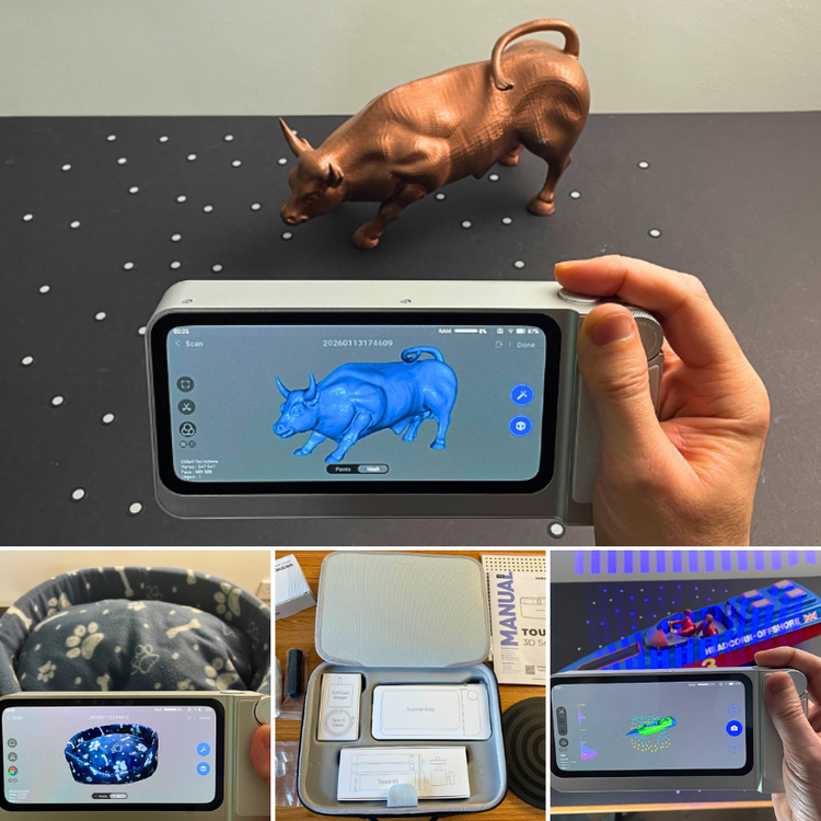

I spent three weeks testing the 3DMakerpro Toucan. As usual, scanning for 3D printing was on my mind, but not limited to it. Here are a few pointers 👇
Takeaways:
• Single Shot (similar to photogrammetry) mode is useful
• Not needing a PC for scanning changes how and where you use it
• Editing/alignment in JMStudio gives more control
