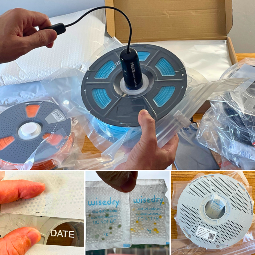

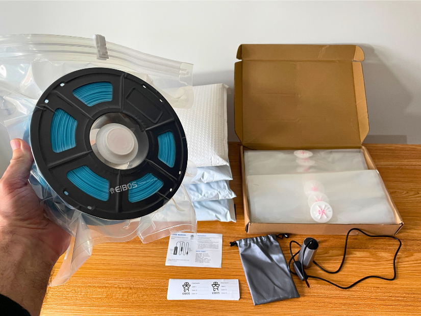

Just gave my first go at vacuum-sealing a filament spool using the EIBOS pump and reusable bags. First impressions? Surprisingly quick and oddly satisfying.

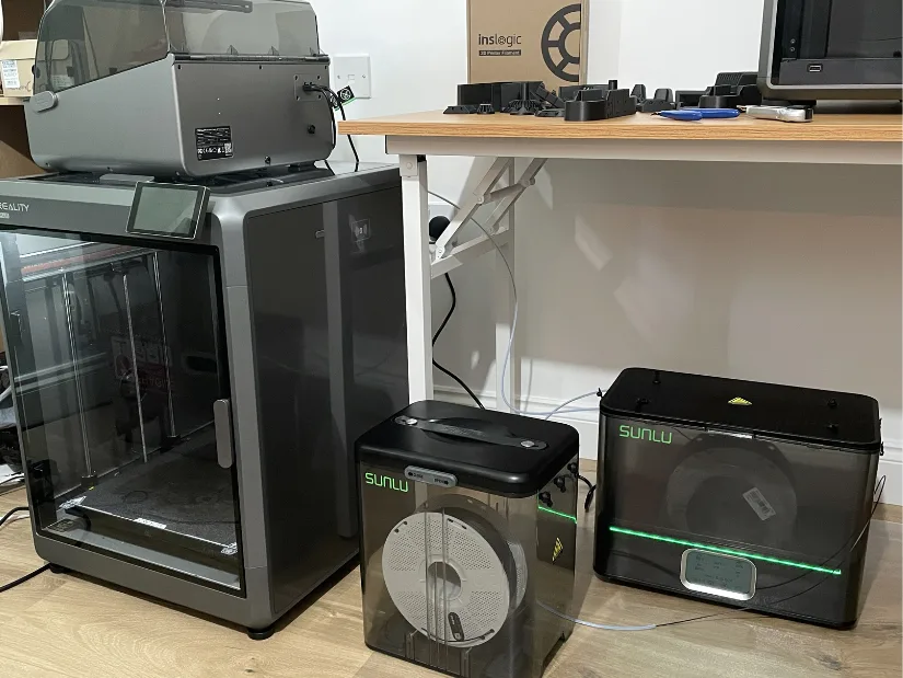

Great attempt! I’ve been wondering whether it’s really necessary to get a filament dryer — have you ever used one?
I’ve tested a few filament dryers and always keep them handy. I would still recommend having a filament dryer available — especially if you live in humid regions like the UK, for example. Moisture is everywhere.
Let’s say you open a spool and leave it printing overnight. When you seal it back using a vacuum pump and desiccant dehumidifiers, that may not be enough to restore the humidity to ideal levels. In such cases, I recommend drying the filament before sealing it — when needed.
It also depends on the filament type. For some engineering-grade materials like PA12-CF, manufacturers even recommend using a filament dryer for a few hours before printing, including with brand-new spools.

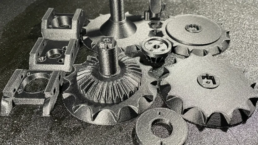

Here’s my test with Inlogic PA12-CF and PA6-CF. Brand-new filament is dried in the SUNLU E2, then fed into the Creality K2 Plus via a PTFE tube. Maybe overkill — but I got beautiful, functional prints!
