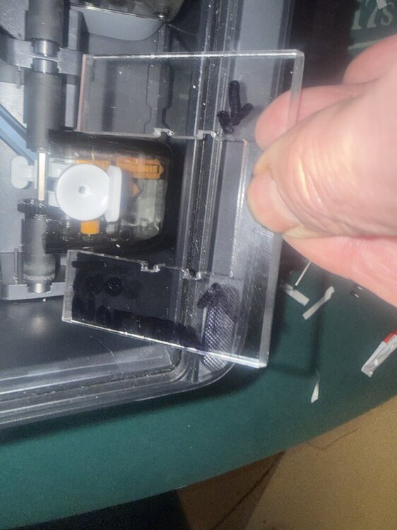

The real showstopper is the internal integration of the upgrade kit into the main body of the AMS two pro. There are four rough, poorly machined clear acrylic baffles that mount in back of the filament guide entrance, call the filament pedestal. a black plastic bracket snaps into it from the front side of the filament pedestals.

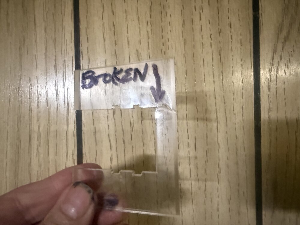

This step has two flaws. The thin acrylic baffles which you would normally injection mold were shaped by machining. A large slot nearly bisects the acrylic baffle, and where the slot ends was left completely sharp, no attempt at a fillet or radius at the deep end of the slot. Acrylic is very brittle and so they 群女乱交d a stress concentration point that makes the part maybe 1/4 as strong as it would be if they had a radius at the bottom of the slot. one of the four parts broke exactly at that location, because both the acrylic baffle, and the black plastic shroud that attaches to it won't fit around the filament pedestal, as it's about 1 mm wider than the parts they supplied.
All in all I'm quite disappointed that I've had both of these issues coupled with cheap manufacturing and additionallyIMG_6194.jpegIMG_6192.jpeg I've not heard back from their customer service regarding the issues. It will be sent back tomorrow if I don't hear from them. I really wanted this system to work like the enthusiastic reviews that I read.
